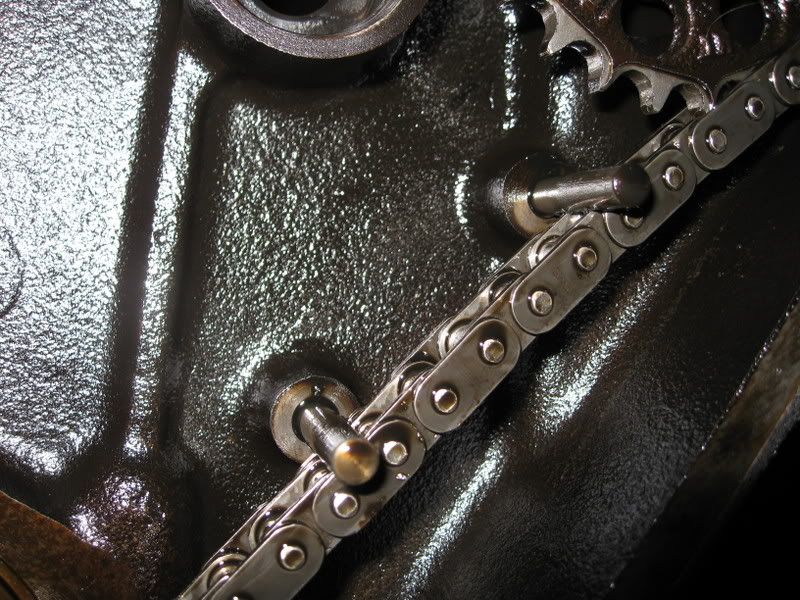

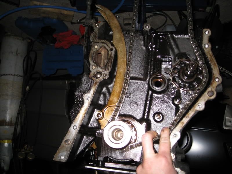

Hallo Freunde.
Here you see the two pins that is holding a sliding rail.
The sliding rail was crushed into pieces and the two pins is in bad shape.
Have been looking into the EPC for 2.3-16 andmy question is:
Is the correct partnumber for the two pins:
032 000007006132 002 CYLINDRICAL PIN SLIDING RAIL TO CYLINDER CRANKCASE
Gruss
Arnt
Beitragvon mbv8 » 18. Sep 2008, 08:26
Hello Arnt,
N 000 007 006 132 is correct.
Greets TT
