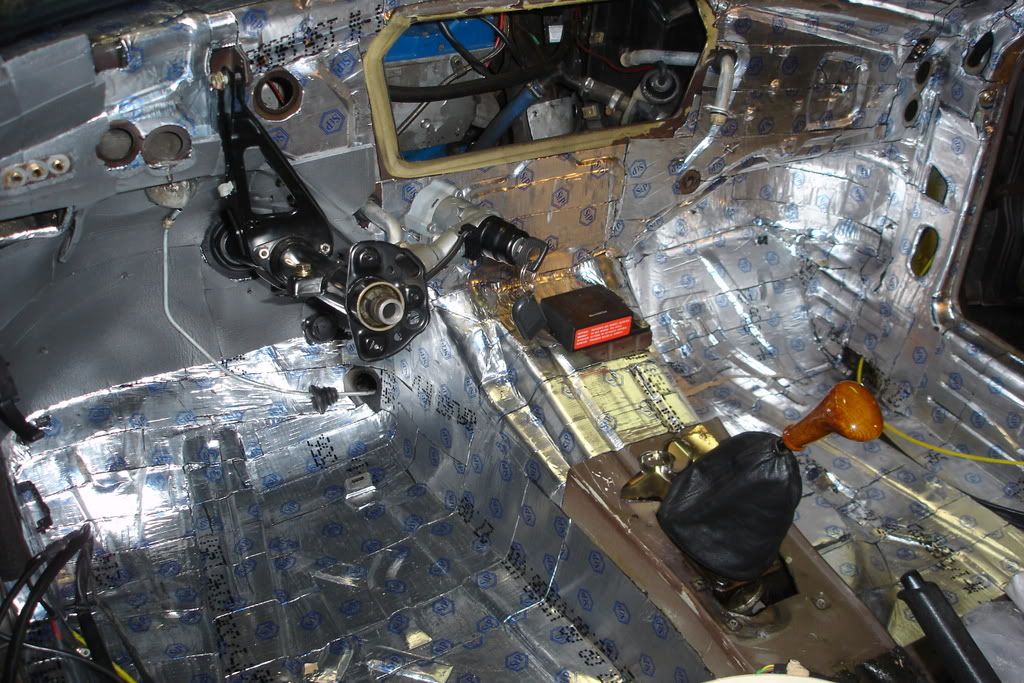

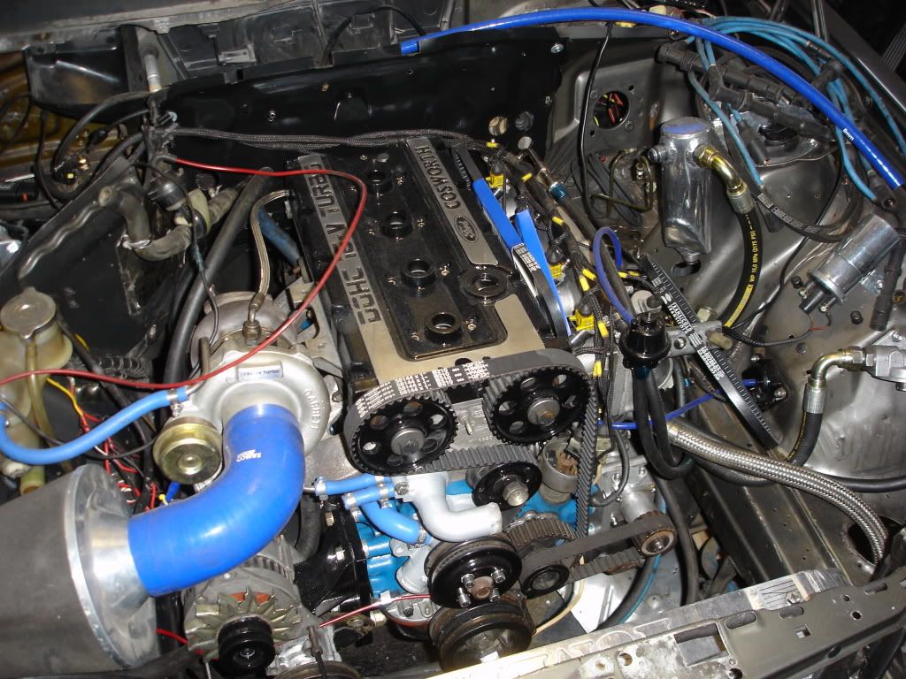

some newer pictures:
He is working on the car now. Next are evoI kit.

Can You tell us about peripheria, what did they use for engine supports and from what car is transmission and differential in current setup?

If you look at the picture do you see the enginemount are home made. I'm sure the gearbox are cosworth and in the magazine it said that it had a modify DTM diff like the one in EvoII in the rear end. The car dont have ASD so I gues it is LSD from 2.3-16, or a LSD DTM-style like the one i have in my evo. Ratio 3.92 in this.
