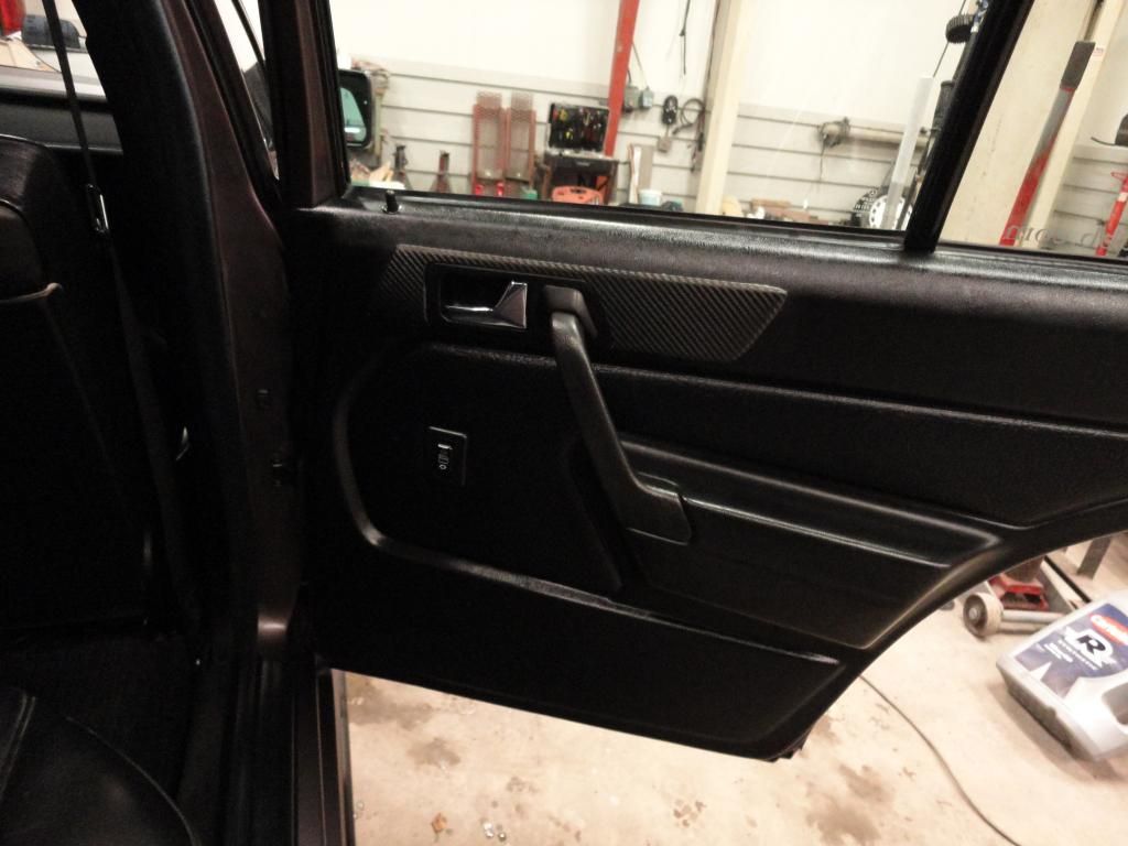

Some doortrim in the rear(front comes later:

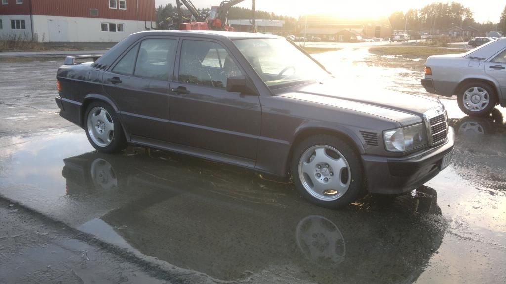

It's time for winter in Norway so I needed som winterwheels. I get some new wintertires in 205/50x16 on my w210 avantgard rims:
