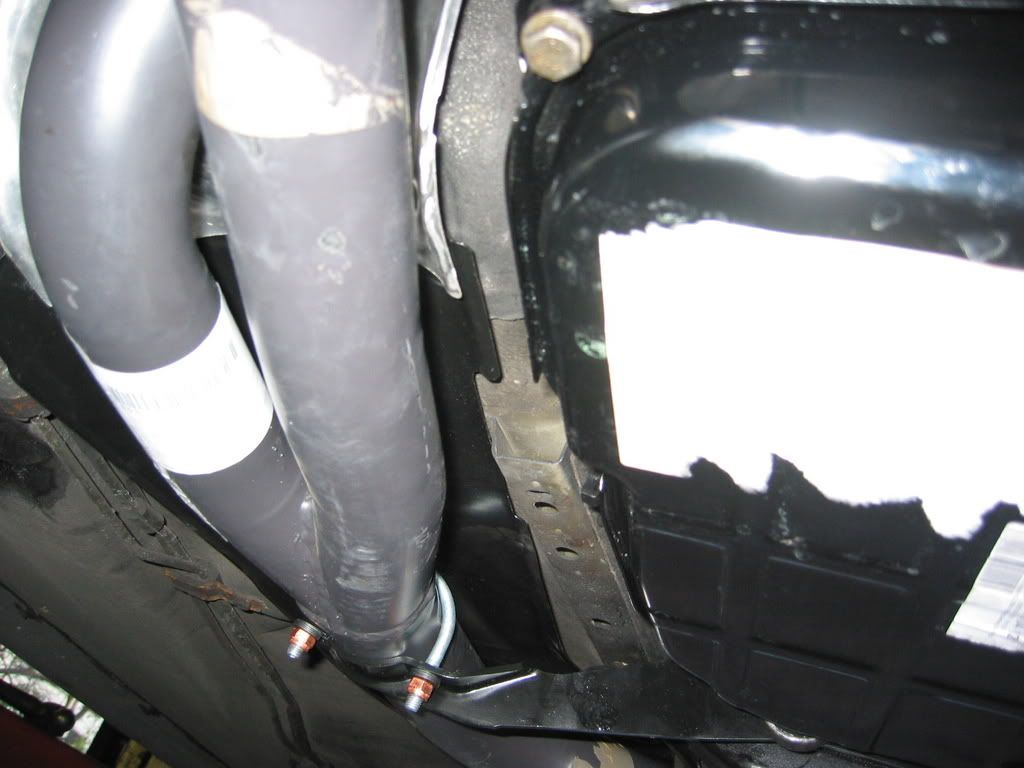

Beitragvon Henger » 24. Nov 2007, 02:07
Hi Zak,
this one is a specializer for noise.
Beitragvon London-16V » 24. Nov 2007, 02:12
Dear Henger,
Thankyou for taking the time to post that picture :-)
As you can see this part is new on my car...But the rattle is still there!
London-16V

Beitragvon Rouven036 » 24. Nov 2007, 15:00
hi london!
i watch to your picture and maybe i see the reason,check the clearance between the heatshield and the exhaust system.
below i marked it on you picture:

Beitragvon Senna » 24. Nov 2007, 17:24
I think there where Rouven show it, can be really the place from where the noise comes.
And even if everything is new, can be that the parts don't fit good together.
In my opinion the noise might come from one of the heat shields, that is around the exhaust system from your car. So if you follow the advise from Tising you might find also the noise.

Beitragvon London-16V » 24. Nov 2007, 19:28
Hi Tising: I always try and do things the proper way! i do not like taking shortcuts at all. So i replaced the entire exhaust from Mercedes. Im not a fan of aftermarket exhausts! Well, in the UK the after market exhausts are pretty bad.
Hi Rouven036: I think you may have hit the nail on the head as they say! That is very well spotted! :-) I am going to get the car on a ramp and rev the engine to 2,000RPM and get the mechanic to look at that part!
Hi Senna: I agree with you even new parts do not fit well together. But a point to make is that this rattling noise was there before also! Thankyou Senna, im going to investigate this further :-)
